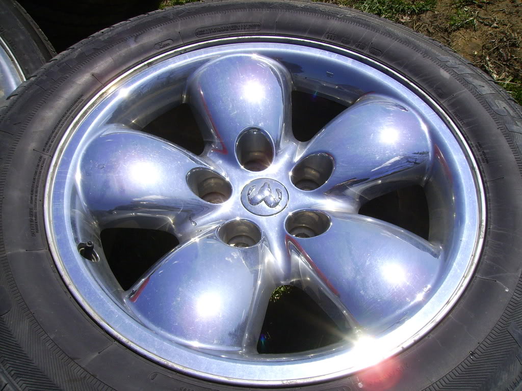

http://i274.photobucket.com/albums/j...e55555/007.jpg
Old Feb 2, 2008 | 05:51 PM
TheForce55555's Avatar
TheForce55555
Posts: 958
From: Southwest, Pa
Default RE: Tuned up the wife's ride
Old Feb 2, 2008 | 05:53 PM
TheForce55555
Posts: 958
From: Southwest, Pa
Sorry Ram2ki, just tryin to get my pic to work, dont mean to jack your thread
