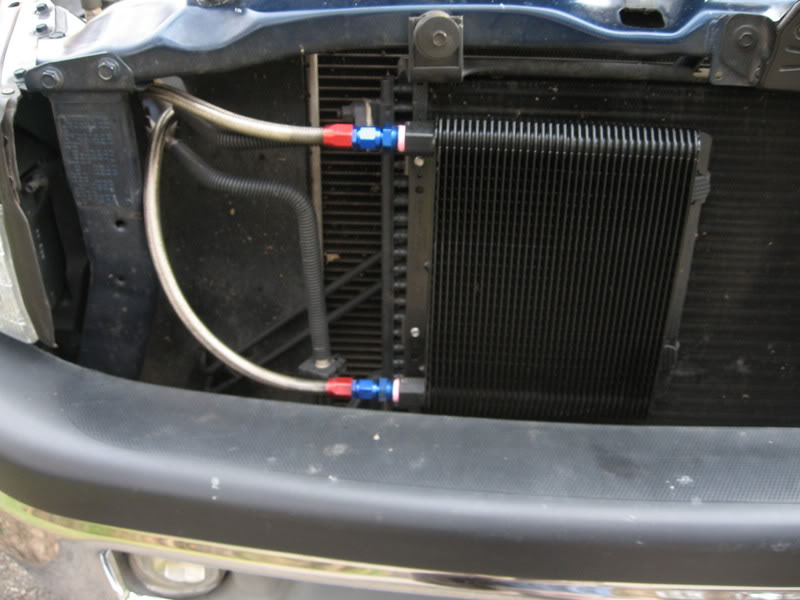

ORIGINAL: Jr. Mechanic
This is the one I recommend: http://www.jegs.com/p/TCI/748659/10002/-1/10535
I got my B&M from there but don't remember which one it was. It was about $100 more than that. here is a picture

Thats why I was wondering.. Cause when I tow shuff for work i know im over the rating.. and I want to do everything I can to keep the truck running. My only has lines in to the radiator and nothing else.. I have never had a light or warning chime come on, but when that happens your normally to late and something will be toast.. I like the cooler I saw on hometheaterman's truck.. I will spend the extra money just want to make sure that it will do something for me.
