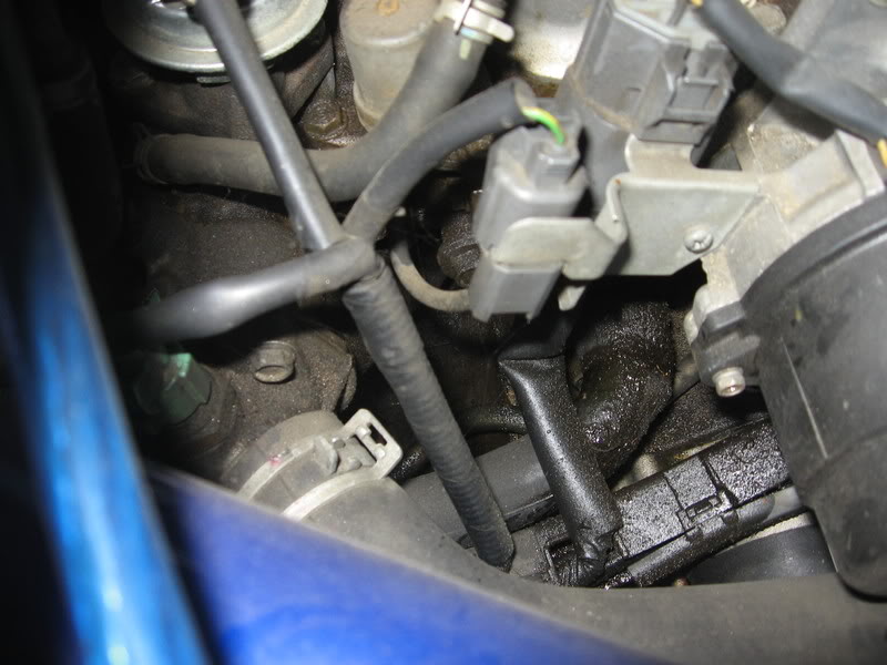

This is on a 1996 Honda Accord EX so it's the 2.2L Vtec motor. I'm hoping to be able to get help fairly quickly as I would like to get this thing back on the road. It started getting hot tonight according to the gauge and steam was coming out near the back of the motor. When looking it was anitfreeze coming out of this spot in this hose. The hose doesn't exactly look like it's a split it looks more like it was made like that but I'm assuming it's not am I correct? Do I just need to replace this hose or is there something else I need to do? What exactly in involved and whats the hose called? Any tips? Does this look like my problem? Here are pictures of the hose it was coming out of.
It's behind the dist sort of at the back of the motor.
You can see circled in red here where the hole in the hose is. It's really hard to see being night so I assume it's part of the hose still as it looked like it.

You can see the hole better here.

It looks like a heater hose. Where does the other end of that hose go? Heater core?

I do work for a Honda dealer.. had one of the techs look at the pic. He said it looks like the heater hose that goes from the head to the heater core. I searched the parts catalog and this is the closest I could find to match that description and your pic. Just trying yo help... get secondopinion to be sure.
Thanks. I've had a few others tell me thats what it was too. I've now just got to figure otu how to get it off with out hopefully removing a ton of stuff. Alldata doesn't tell you how to change it just how long it should take.
