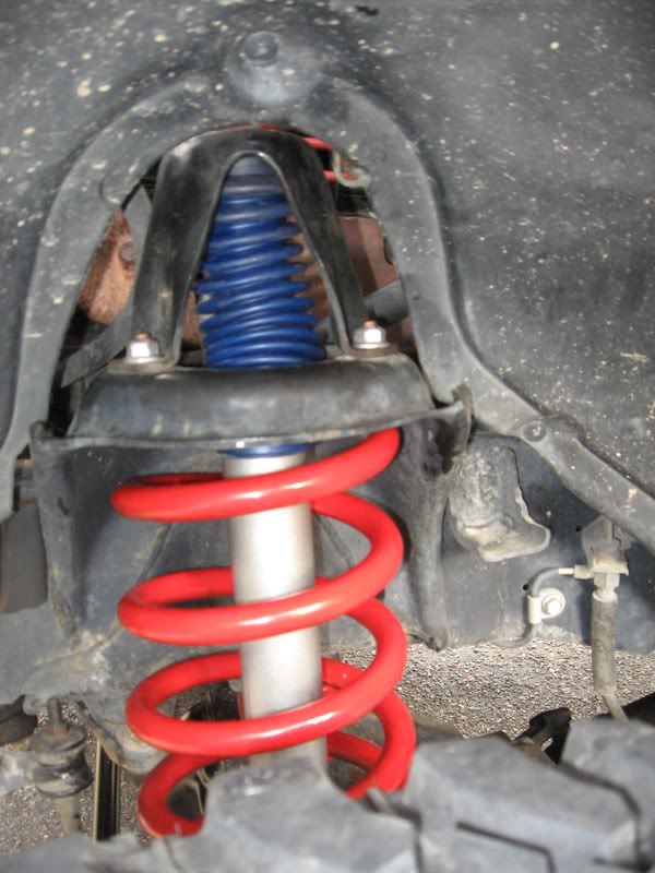

BTW since I was telling you I'd just go with a longer coil and not spacers here is what my front suspension looks like
Now unless you get a older Skyjacker kit I think Skyjacker powder coats them black instead of red now.
The Skyjacker kit also comes with lower control arms that look nice but you don't need those with just a 3" lift. You only need those with more than 3".
BTW if you get a 3" lift that comes with spacers you are going to be in the same situation as you are now. You can't use a 3" lift with spacers on your truck unless you take the offroad edition coils off and put regular model coils on. I personally would get a kit that has bigger coils like the Skyjacker to avoid all that.
