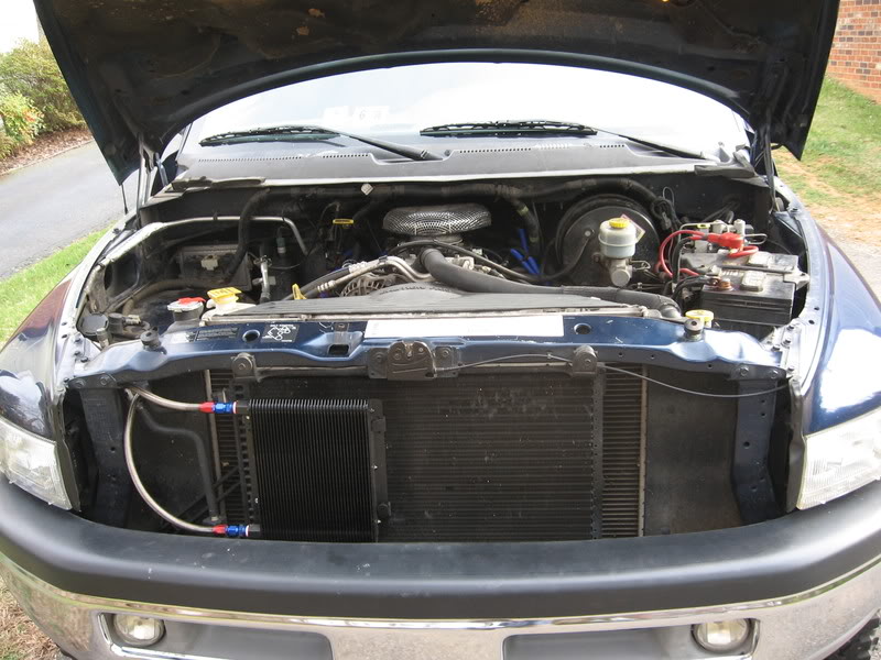

Old Aug 8, 2008 | 10:18 AM
hometheaterman's Avatar
hometheaterman
Joined: Jan 2005
Posts: 4,268
Yup when I had my APS tranmsission installed I had a B&M transmission cooler put on without the check valve.
