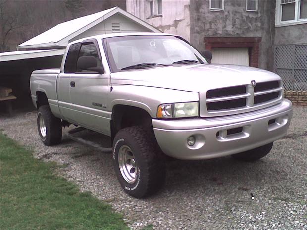

2001 Ram 1500 Quad Cab 4WD Sport 5.2.
I bought this pig used three years ago from a dealer in VA. It was in pretty nice shape and haven't had to really do much except some of what I considered to be routine maintenance for a 85K engine when I first got it. Did the plenum fix and while I was in that far did a new timing chain and gears plus a new water pump, plugs, wires, KN drop in plus the regular oil changes and lubes plus some other little stuff like a $4,000.00 sound system, lol.
