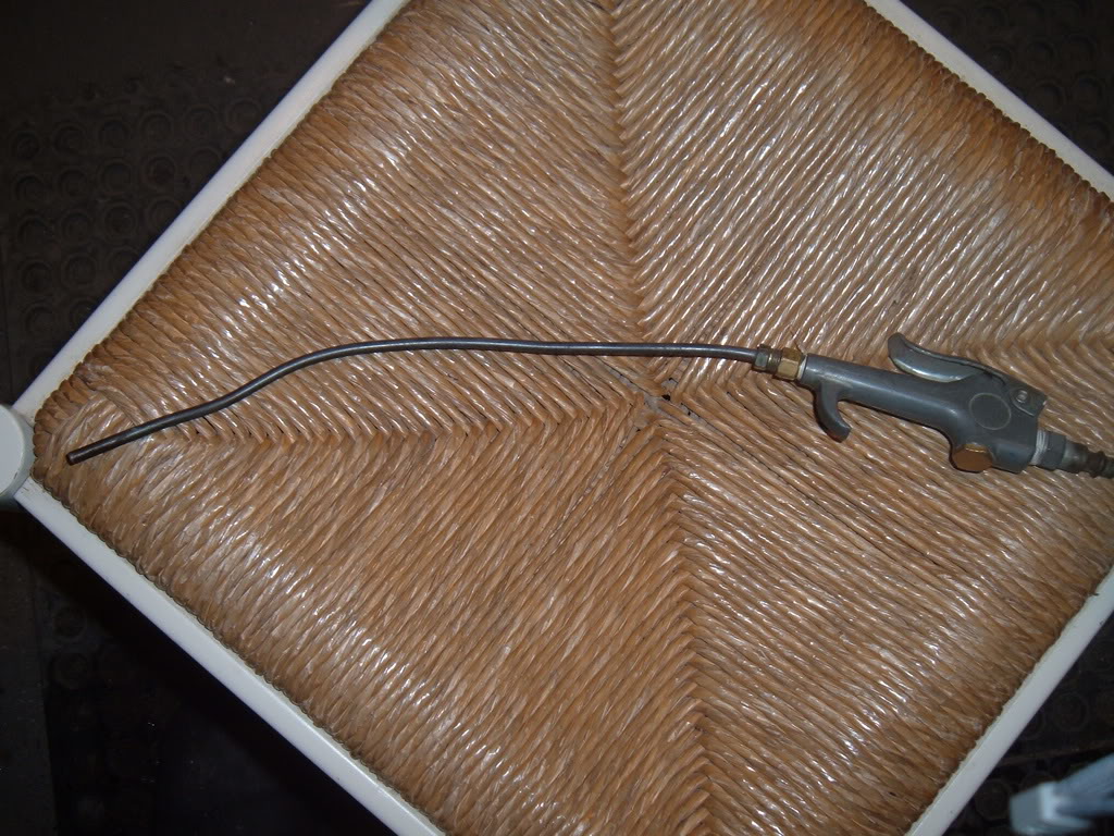

Originally Posted by aim4squirrels
A couple of other tips:
The little tabs that hold the wiring harnesses down to the valve cover bolts come off easier of you push up from underneath with a standard screwdriver
After you get the plug wires, wiring harness, and everything out of the way, just before you pull the covers, either shop vac out the little channel between the valve cover and intake manifold, or do I like did and grab the leaf blower and blow the whole area clean. That'll keep a load of stuff out of the heads when you pull the covers. If you do get some stuff in there and it worries you, just wash it down and out with a cheap quart of oil and let it drain straight out of the oil pan.
Or you can do this to your blow gun if you have a good Name:  DSCF0478.jpg
Size:  209.0 KBcompressor,
