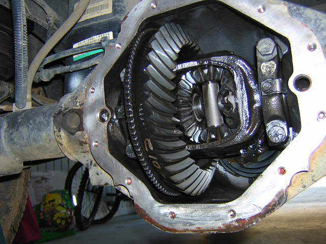

ok so far so good, i got the atf 4. and for the axles i got 75-140 since im towing, i also got the oil modifier but not sure if i need it or not. how do i tell if its LSD ?

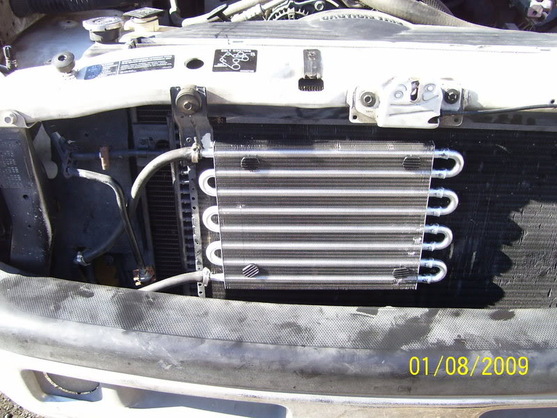

where u get that tranny cooler and are u going to install like that other one ie link thats on here?
Jack up the rear of the truck. With transmission in neutral, spin one of the rear wheels. If they both spin the same direction, you have an LSD.
If they spin differant directions, you have an open differential.

this is an open diff (non-limited slip). note the side gears on the ahh, side, and the spider gears on top and bottom. this one doesn't need the friction modifier, although it won't hurt it.

the tranny cooler i got was from advanced auto, 40 bucks and yea im going to install it like that one i posted
thank you very much for the help everyone, i might be able to make my trip after all, if everything goes smooth
take some more pics that one was missing that part cause i want to do the same well get a bigger one my truck has the stock one.
