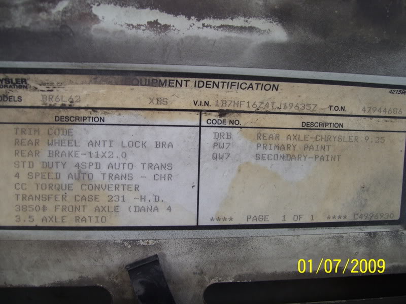

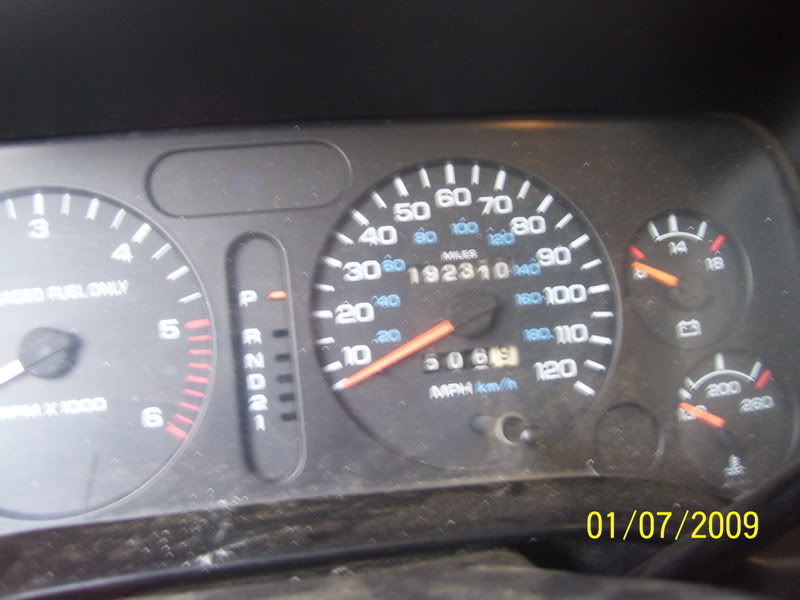

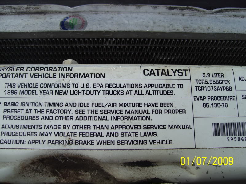

hello, im new here and really could use some help, i recently bought a 1996 dodge ram 4x4 for a tow rig, it runs great and shifts great, everything works. i was very happy with the purchase untill a few days ago i been reading up on this site, now im terrified of this truck. i was planning on going on a long trip ( 2000ish miles) in a few days. but now i dout i will go. i have a few questions i was hopeing someone could help me out with. i was wanting to change all the fluids on this truck and jus hit the road. i changed the motor oil and filter, than i was going to flush the trany oil cuz it looks brown and smells burnt, but i was reading if i flush it i might cause the trany to fail and i dont want that. what should i do about the trany ? this truck has 190,000 plus miles on it i have no past records on it. i changed the oil in the transfer case with ATF 4 when i drained it, only like 2 ounces of dark brown nastyness came out ( that kinda worried me) any help would be great, thanks in advance.

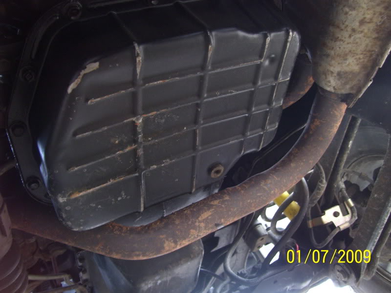

you'll have a rh46 transmission. i see a drain plug in the pan. i don't think thats original, so its been changed at least once. its likely been rebuilt somewhere along the way.
this is just me, but i'd change fluid and filter with atf+4 and drive it a lot for at least a few days. then i'd change it again. the reason i'd do that is because changing the fluid only gets out about half of it, plus, the new fluid has new detergents that get all the sludge stirred up. its my suspicion that the stirred up sludge clogs the filter and causes the failures that occur after transmission service.
