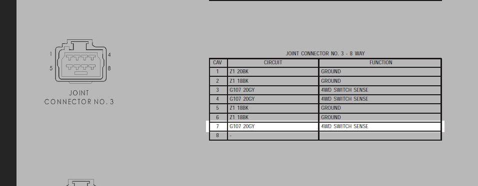

Hey TMS Bill, the picture you took of that harness IS NOT a fog light harness. I don't know what it is, but it's not a fog light harness. the harness is suppost to be under the radiator more or less in the middle. It's oval with 2 blue wires and one black. The one you took a picture of, I have that harness to and I STILL don't know what it's for either.
According to the diagram on page 1112 of the service manual, that is connector C106. C106 has 2 forms. One of them is closed with what appears to be a terminated plug, the other is open.
C106 is connected to G107 20GY. According to the diagram, Pin G107 20GY is listed as "4WD SWITCH SENSE"
C106 also has a listing for connection G107 18BK/GY. (Z1 18BK are both grounds) This took me to this connector:
And there you have it, those connectors are connectors for some sort of 4WD sensor.
