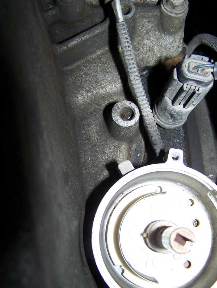

I couldn't see in the distributor, but took a picture of it. With the ignition pick up removed I didn't see any other sensors or wires. Is the ignition pick up also the cam sensor? If not, do u need to remove the distributor to access the cam sensor? I should mention that last week I didnt know much about a 98-360 ignition and as of now I still don't know much, trying to get to a point where I know a little and can guess the rest.

The cam sensor is the pick up sensor, it's the flat plate that sits between the disty and the cap. DON'T take the disty off or you'll probably have to take it to the dealership to have the sync set. You can't tune these engines by twisting the Disty like in the old days.
