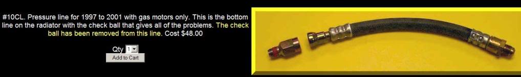

I ordered one of these. I wish I had time to make one from aims nice DIY.
If I actually get it, I'll let you know how it looks.

Yes please let me know...i just don''t have lots of time these days and would like to just order one too....I will be anxiously waiting for your reply..and thanks to the ones that have replied..
Holy crap! $48.00! The actual trans cooling line (the steel one and the rubber one) with the check ball in it is only like $26.00 at Murrays
Yes ... but this one has been up(down?)graded. It's mo' betta'.

so would u guys just replace the check valve...or completely get rid of it...seems like just getting rid of it is a better deal...as for the cost of the hose and control valve...the $48.00 is without the ball right and the $28.0 is one with...less is more? Kinda like a diet I guess...should I buy the $48.00 or the $28.00

I think if you look at AIMs write up you can make your own for like 20-30 without the check ball. That is the way I would/will go.
