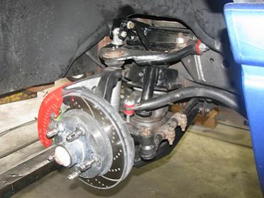

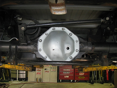

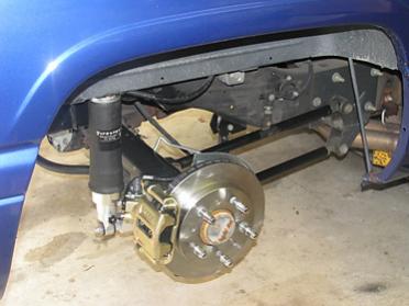

I just completed the installation of SSBC's rear disc conversion kit on my 96 Indy Ram. The components supplied are top notch - however, be prepared to do some fabricating.
First off, the instructions are text only, no pics. Although very descriptive, pictures definately would've helped. Second, all of the holes in the mounting brackets had to be drilled out and opened up (a little annoying). Also, the inner part of the caliper had to be ground down b/c the rotors were rubbing them.
I decided to use Russell's 9" braided lines in conjunction with the parking brake L-bracket which SSBC supplied to transition from the flex to hard lines. The lines which they supply are way to short to do anything with. This is probably the only part of the installation where I felt their product fell short.
They also included a larger master cylinder which needed to be swapped out.
The hardlines needed were bent up by me along with a double flaring tool.
Please note, that their conversion kit call for the axles to come out, so an extra set of hands helps.
I included shots of the front and rear for your reference.
I'll let you know how well they work.

I don't know if you guys can see the four-link, shockwaves, & airbags in the photos.
Old May 24, 2009 | 10:38 PM
dodge15004x45.9's Avatar
dodge15004x45.9
Joined: Nov 2008
Posts: 7,950
Yea can can see the 4 link and all that.
