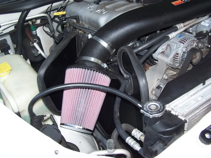

The idea of a CAI is not to get cold air to the engine, just cooler air than what the stock airbox provides and more of it. In the case of my V10, the stock snorkel goes to a box mounted right behind the rad, A/C condenser coil and tranny cooler. And its opening is about 5X3" and points backwards towards the firewall. great for evaporative emissions, terrible for performance. The K&N CAI puts the intake opening on the opposite side where the incoming air only has to go through the rad because the condenser and tranny cooler do not extend that far and the open element gets a bit of a ramair effect at speed. The metal enclosure keeps much of the engine heat out, but mainly it allows the cooler air coming through the grille to surround the filter element. Coming back from the track yesterday (180 miles round trip, almost entirely freeway) I actually hit 13mpg, a first in my V10. Once I got off the freeway it backed down into the 10-11 range, but I had never gotten above 11 before I installed the K&N kit.

Here's the filter end of the CAI. Much more area than stock and a better place to draw intake air from.

Like I said, if not for the side-draft design of my TB and the illegality of it, I would be running a round air cleaner, too. It would have been a heck of a lot cheaper than the $278 I paid for the K&N CAI. I just wanted to give you a better idea of what a well-designed CAI does, but I doubt the performance is any better than a 14X3.
