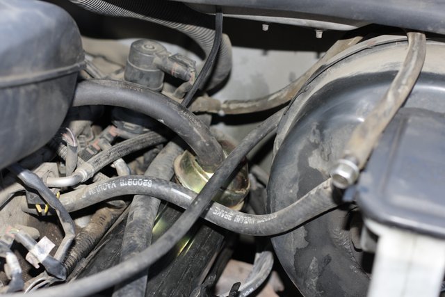

well i checked and the one going into the intake manafold leaks when I blow into it so I will go to the dealer to get one.
Also can anyone tell me what should be on the end of this hose that has a bolt in it. I just noticed it was not going to anything.

the PCV valve fixed the vents for me.
that hose is attached to your evap purge solenoid. it shouldn't be plugged off. i don't know if that is the line that goes to the tank or if it is the vent hose.

i wouldn't unplug it until someone with a 97 or older ram tells you where it goes.
