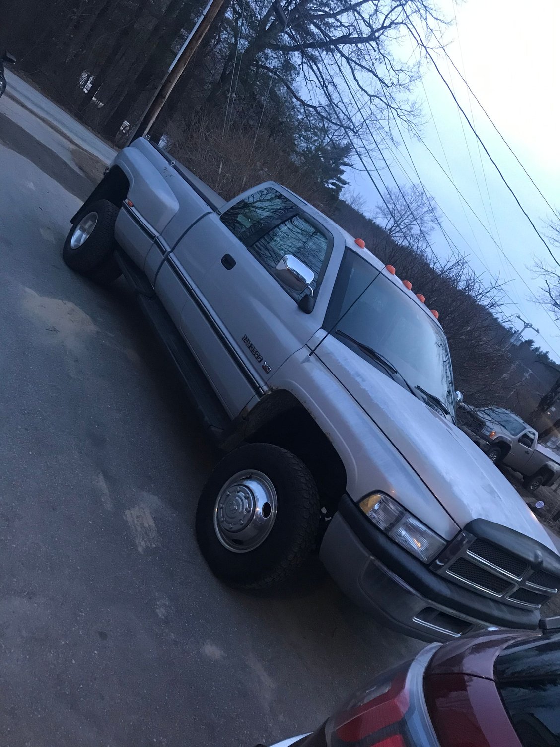

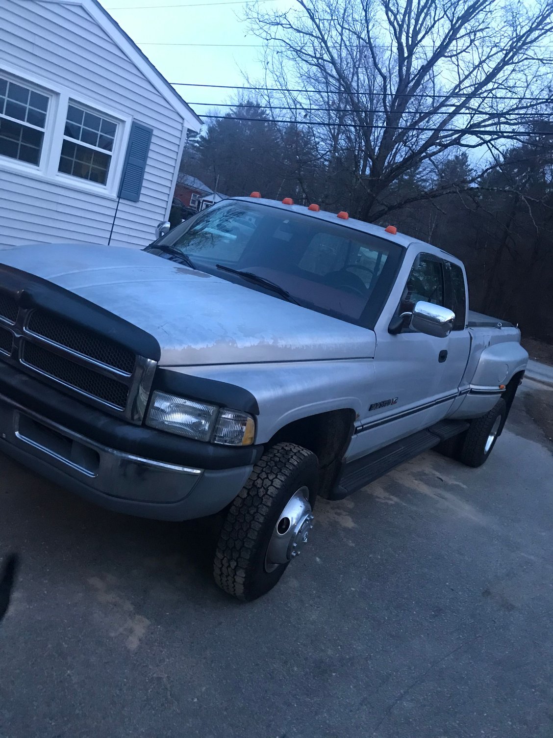

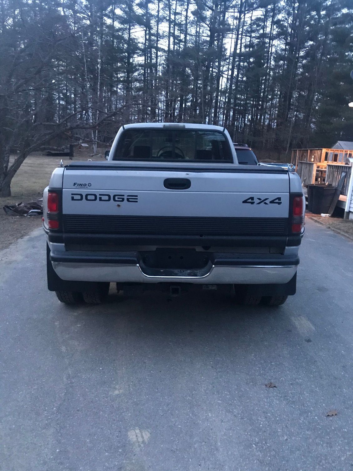

Hi I just bought a 95 3500 V10 with 110k. New to owning a dodge I do concrete for a living and wanted this as a work truck. Everything on the truck is awesome but it has a weird tapping sound. Almost like a stuck lifter...? But when investigating I noticed the harmonic balancer has a wobble to it. Do all my own work on our fleet but never with a dodge. Would this cause a weird noise to come? What’s it in tail on fixing? Is my crankshaft misaligned now?
this is my new to me one ton. I think it’s a hell of a truck for the $3500 I paid. Hopefully it doesn’t need a motor rebuild
