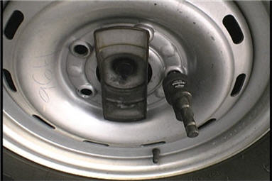

Nah, I'm the original owner. I remember when I bought the truck the dealer giving me these two little master lock keys and I didn't know what they were for. They told me they were for the spare. I dunno if this lock was standard in 97 or part of the Laramie SLT package. The set up is really simple. The winch is the same as yours. Next to the winch there is a rod attached (not removable) to the bed. It slides down 7 or 8 inches and you slip that through one of the holes in the spare tires rim. When you have the wheel all the way up you slip the lock through the rod. The rod has notches in it for the lock to lock into. The lock is covered in plastic to protect it from road crap. It's a simple yet elegant design. I would get a pic but my camera is dead.

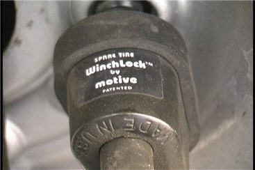

OK, I borrowed a camera and got you these pics. Hoprefully they can clear things up and I think you can fab something up like this yourself. I even too a pic of the manufacturer so if they still exist you can contact them and get the parts if you like. If not I think you could create a rod like this hanging from the bottom of the bed, cut a few holes in it and run a pad lock through it.
BTW on your improvised winch, why dont you create something similar to the end part that was there by using a strong washer and a bushing of some kind at the end and hooking up the cable to it. Instead of using the clip with the nuts why not use a pressure clamp where you just crimp it shut. I have made many cables with loops on the end and I just use a crimp clamp (I forget what they are called). Those crimp ends are pretty strong too. I once had my Honda die a few blocks from my house and didn't feel like paying $100 to be towed 3 blocks so I got one of my home made cables and towed my Honda home behind my truck. Before you ask, no I did not have a tow cable or I would have used it. Had to do it at night so no cop would catch me, hehehe.
