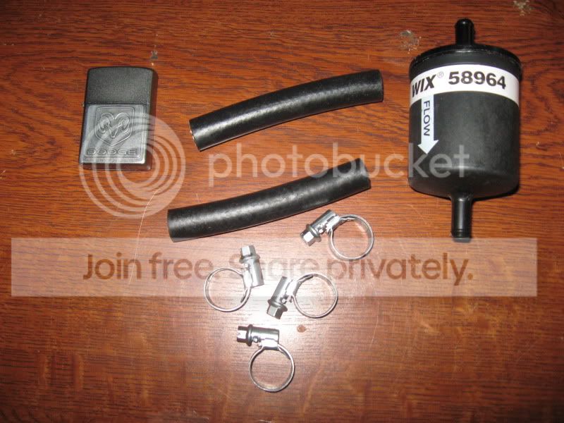

Title pretty much sums it up, but I will add a little more.
Over the last few weeks, I've been putting together a list of basic maintenance parts together, and today, I went and picked up most of it.
I use Oriely's auto, and have always been happy with the service and correctness of the parts, but today makes me wonder a little bit. Firstly, when I went in, I started off with asking for a new pan gasket, of course they didn't have it, and that's to be expected. Then I ask for the filter.
Let me back up just a second here first. When I first asked for the gasket, I told the clerk I needed a pan gasket for the 46RE transmission. I guess that confused him enough. We had to go through and punch in the make and model. What ever, just get my my gasket.
This was an older guy, and he tells me that there is no way I have a 46RE in my truck. He tells me that I either have a NV3500, 36RE or 36RH I told him, that's a typo. We had a good 15 minute argument on this. .
I ended up getting an out board magnetic filter made by wix.
Did these trucks have this? I don't really think they ever did, and it's another typo in their parts catalog....
TIA.
(I did search, so no comments Miami. )
Here is a pic if anyone wants to see what I'm talking about.

that looks like a fuel filter to me. edit - ok, i llooked it up, its for transmissions.
http://www.wixfilters.com/filterlook...sionfilter.asp
but anyway, my 01 doesn't have any external filters, gas nor transmission.
i suppose it'll work, but you'll have to cut your hard line or quick connect hose.
i put a remote filter on mine. it uses the standard F1 or FL1? oil filter.
Yea, I see that now, thanks. Also read the note at the bottom LOL

It's another typo in the catalog for the parts store.
It honestly doesn't look like something I would want to use in that situation IMO. Looks like it would be really easy for a hose to blow off or something. Oh well, lol good store credit.

i will actually work fine, although its a little pricey to replace. there's not an excessive amount of pressure on those lines. my cooler and remote filter are plumbed with rubber transmission hose and regular old clamps.
i used this one, but i don't like it because the fittings are straight up. 90* would be better.
