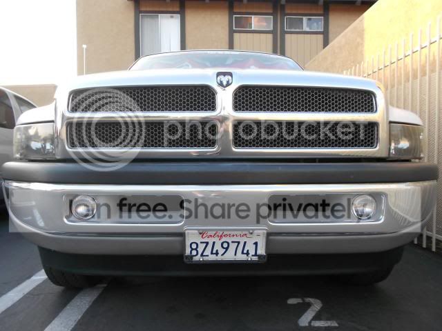

Here is my 97 Ram 1500 with old lights:
Attachment 43640
With the new lights. what a difference!
Attachment 43641
hey can u show the plug and wire harness behind the factory fog light button on dash ive been tryin to figure out where i can find it ive got the fsctory foglights in bumper nd the wire harness that t off from a connector next to the steering box got a oem fog light switch to put next to the o/d button on the dash need to figure out where that harness that plugs into factory foglight switch
