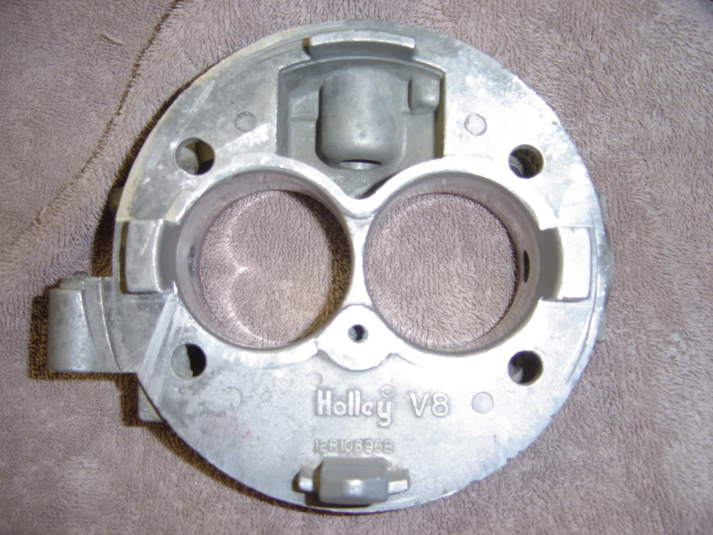

did you cut the air thors and bored it straingle throw(no more hour glass) on the tb?
like this
if not you need to!!!

...and dodgeram07, yes my tb is bored to 50mm but not quite like yours. ill get a pic in the daylight and post it for you.

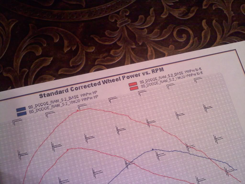

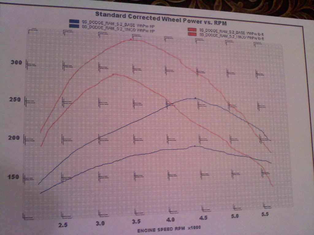

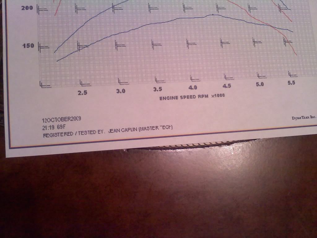

257hp at 4450rpm and 342lbft at 3490rpm
Thats a 76hp gain and 52lbft gain!!!!!!! I LOVE MY TRUCK!
...and i still dont have my headers.
(of course that means new flash...whew)
