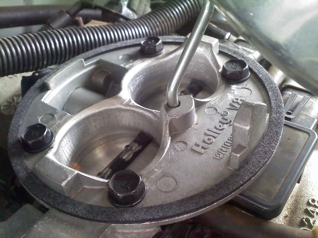

i said i would post a pic of my throttle body work.
i just bored it out, removed most of the horns, and made new butterflies.
i didnt remove all of the horn because i was scared my cheap CAI wouldnt line up.
it moved 860cfm at 25" ...not bad for a "stock" TB

...and i think i can do it...hmm (brain smoking) ~~~~
all i would have to do is remove the meat between the barrels and make a single butterfly. i can do it... I CAN DO IT ALL NIGHT LONG!!!
has anybody used this monster???

Hey man you've been doing a great job and I think you should keep doing what you think is
right ........ but ..... In my opinion that is too much throttle body for your application.
