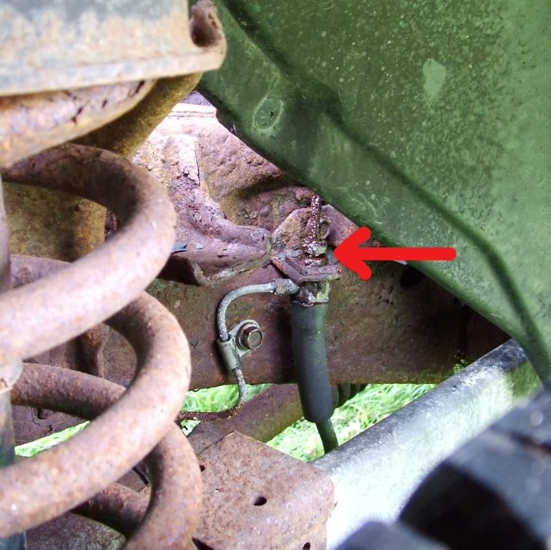

It appears to be both metal lines that come out the bottom of the cylinder and lead to the brake lines. They're rusted, as is alot of the undercarriage metal (probably due to parking in the grass for extended periods). Pics:
Are these metal lines easily sourced and replaced?

Remove them, take them to an auto parts store and match for size and length. Buy a tubing bender and go to work. BTW, I wouldn't drive mine if it was that rusty (and it's rusty), even the brake booster is beyond words. Parking in grass has nothing to do with the shop that has fixed it.

try using the new teflon brake lines, there supposedly not supposed to rust out, and i believe the size was a 3/8's brake line
try throwin some undercoat or something under there....thats a lot of rust, no offense

Yeah, you really need to do some stuff with that rust. I'd take a couple weeks (If you have a spare car) and start to remove that rust with a grinder and paint it with some POR-15 or other frame coating. Pennsylvania winters have not been good at all to your truck!!!
