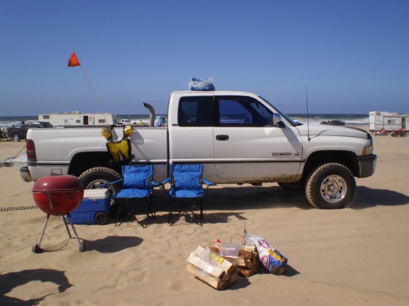

I just recently picked up my first ever truck (after only riding motorcycles for the last 5 years). It's a 96 Dodge Ram 1500 5.9 ltr automatic. I havnt really had to many issues with my truck but in the last couple of weeks Ive noticed some weird characteristics.
first, I just picked up some new tires for my truck and I notice when I'm parked and shift it in drive, every now and then when i first start rolling I sometimes feel a jolt. It feels like something may be working harder to move the new tires (drive train possible, i dont know). This only started happening once I got new tires on and does not happen everytime.
Also, It's just now starting to get cold in California and I noticed when I was driving to work in the morning, It appeared my truck wasn't kicking in to over drive. Later in the day, when I was driving home, over drive seem to be working just fine. Does the transmission need to warm up to a certain temp before over drive gets enabled?
Like I mentioned, This is my first truck and I'm pretty much mechanically declined. I appreciate any suggestions.
