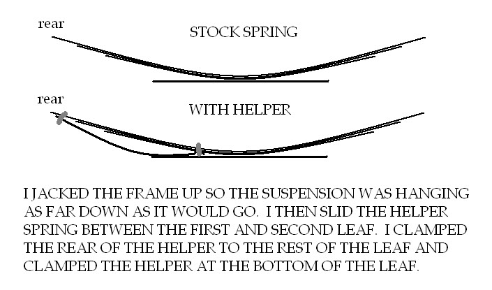

well 1" doesn't seem worth the trouble. and my shocks are brand new so i don't want to have to get new rears.
i was planning on getting shock extenders for the front anyway, does anyone know if there is anything that will extend the rear shocks available?

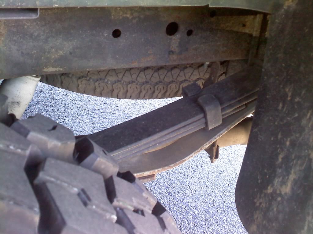

try this...and youll just have to follow me on this for a minute.
http://www.amazon.com/gp/product/B00...FCQHQ3JGT1ENPT
now, i know these are crap if you install them the way they say to do it...however, and i do mean a big HOWEVER, if you do it like i did...WOW.
i got 2.5" of lift at the rear of my truck by doing this.
