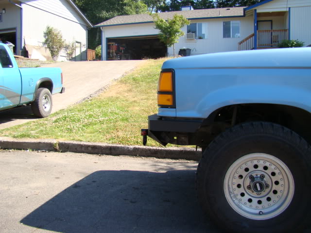

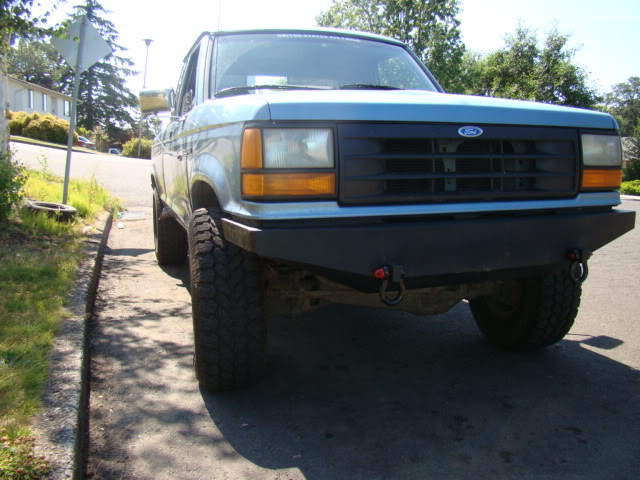

1/4" works good for mounts/brackets and the center of the bumper, 1/8 when triangulated it pretty damn strong for the outside of the bumper. 3/16" is a good compromise. C channel also works but it's kind of a pain to work with. Just don't go absolutly huge, think about approach angles and such.
Bumpers I've built
Shackle tabs inside the ranger bumper.
My B2.

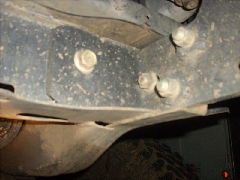

heres the pics
Old Oct 23, 2009 | 10:31 PM
  #38
dodge15004x45.9's Avatar
dodge15004x45.9
Joined: Nov 2008
Posts: 7,950
Did you just get ride of the stock brackets out right and make your own? Are they 1/4 bolts or 1/2 bolts.
Old Oct 23, 2009 | 10:38 PM
  #39
dodgetrucker75's Avatar
dodgetrucker75
Joined: Aug 2007
Posts: 2,283
From: live oak, ca
oh ya, no stock brackets... on this 98 the brackets are 1/2'' and the rest of the bumper is 1/4'' and 3/16'' and all 1/2'' geade 8 bolts
