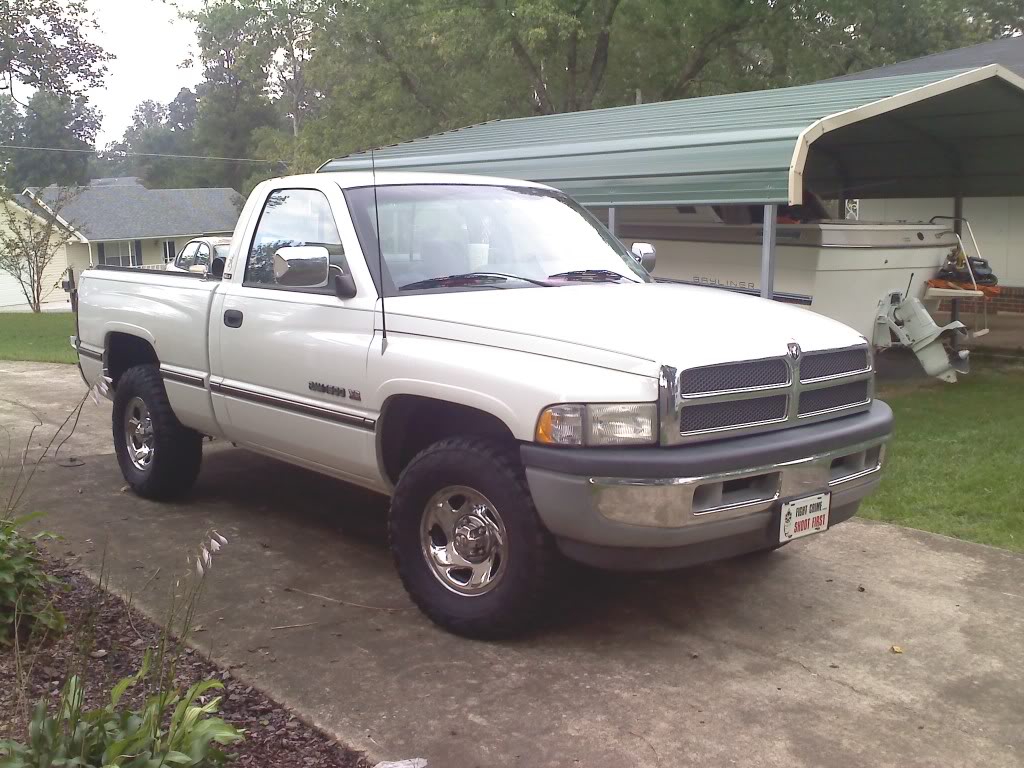

you got pictures of your truck...? im confused on the whole lift idea.
you have a 2.5 in spacer...dont like it...so going to a 3.5 in spindle...?
what about the rear?
you aure are going through alot of work for 285s.
i have 285/75 16s on a 2wd with a 1.5 in CSS and AALs.
plenty of room, and ill have to admit, they fit on the stock rim better than i thought they would.

I'm out of town right now, so no pictures unfortunately.
I don't like the spacer because the truck rides like **** because of it. It's like an extra 1500 lbs of tension on the coil that makes the ride really really rough. So I'm going to use a spindle and ditch the spacer, that way the factory geometry is retained, only the snout moves.
