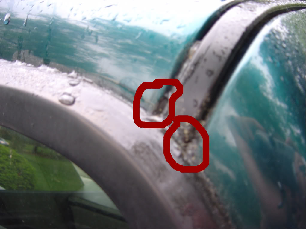

also check this area,, my brake light and this\/ were leakin

+1 on the third brake light, but you would notice it before it hit the floor.
(had leak there on mine)

I'd like to thank the guys who replied to my question. It seems that the problem is, indeed, the brake light. I sealed around it and the floor is starting to dry out (that takes awhile; we get about 150" of rain per year here in Hilo, HI).
