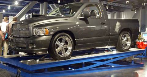

Id be more than happy if I could get it sitting like this
Attached Thumbnails Lowering my 96 Dodge Ram.......4x4 :(-myramcaddys2k.jpg   Lowering my 96 Dodge Ram.......4x4 :(-dodgesema.jpg

those are 2wd truck the indys , its prob going to be hard to get a 4x4 that low
You wont be able to lower the truck that much, the diff housing will hit the chassis before you get that low.
