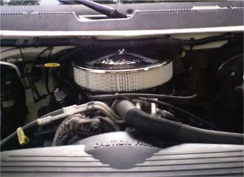

A housing that is open? You don't have a stock airbox?
Does your aircleaner look like this?
If so, the hissing is normal, especially in cold starts.
