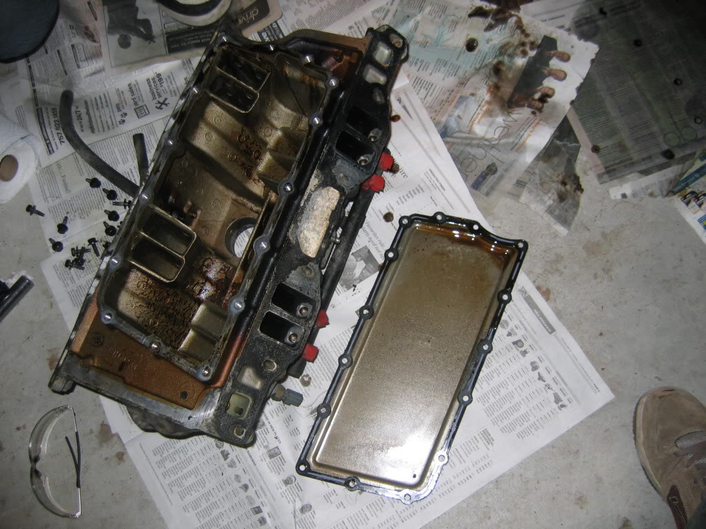

Over my 5 day weekend, I decided to do a little work to my truck. Here's my list.
Plenum Fix
Cap and rotor change
Oil change
Clean oil pan
Plenum Leak Confirmed!

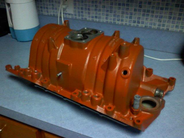

Behold! The Great Pumpkin!
Finished product (forgive the glare)

wow. that thing is cool orange.

pretty nice you should panit your 14x3 the same color to match that would look cool

any difficulties? suggestions for others who plan to do it? I just ordered mine and will be installing over Christmas break.

It takes time, that's for sure. My best tip for easy removal is to go ahead and remove the accessory rack. Also, take the manifold out of the truck before trying to pull off the fuel rail, but you shouldnt have to do that unless you're painting or modifying your intake manifold. The only difficulties I ran into later were my own stupid mistakes ie: a forgotten wiring harness or untightened bolt. Just take your time and get a Haynes manual. It helps out a lot.

yeah best way to do it is to take off the accessory bracket by removing like 5 bolts a pick it up and flip it upside down while putting it on ur passenger side fender. be careful not to break the two hoses going to it though.

nice job. how's it run ?
