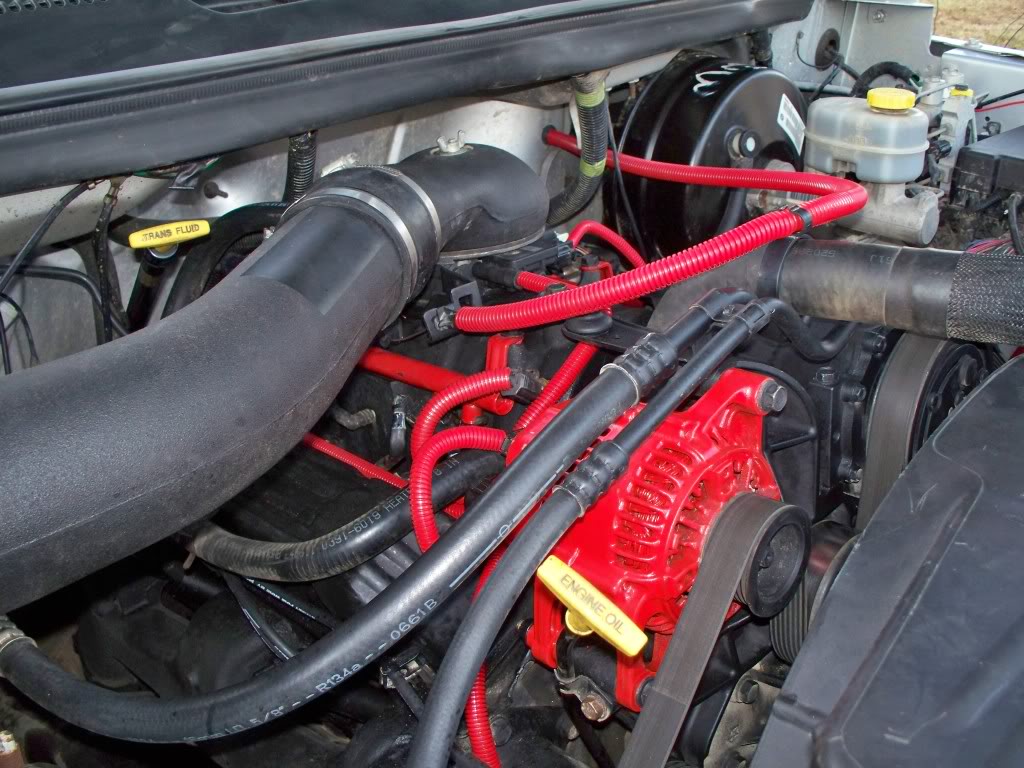

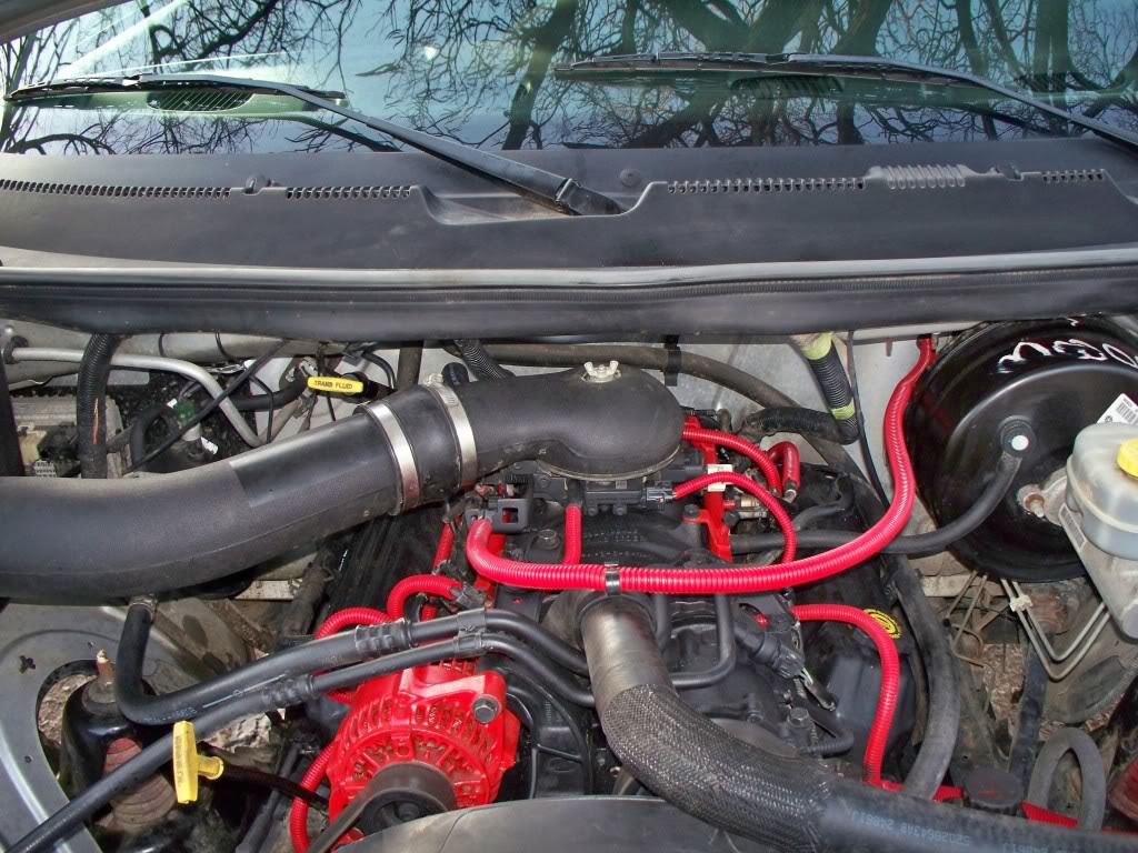

well im finished with the plenum fix and keggar mod, i also painted up a lot of my engine parts and did a tune up, hypertech 180 t stat, MSD 8mm streetfire plug wires, E3 plugs, mopar performance cap and rotor and all felpro gaskets, i had a few snags with the coolant temp sensor and the front left bolt on the intake manifold, i drilled the bolt out and went to tap it and the tap broke inside the whole so i just hoped that it worked and i havent seen any leaks, i sprayed some starter fluid at it while it was running and it didnt bog or rev so i think it will be alright. anyway here are some pics of the finished product.

Looks good. A bit bright for my liking, but clean!

looks better than mine

On the Alternator, I thought you couldnt just shoot paint on it because of the wiring inside. Someone told me it would mess with it. It looks like you just shot paint on it with out taking the housing off. Is that true?

i just shot it and its fine

i did cover up the ground and plug connecter before i did it, and i didnt shoot the inside just the outside, the the inside of the coils are still unpainted, the outside of the coils dont move and shouldnt hurt it al all, its still charges my system well.
