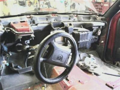

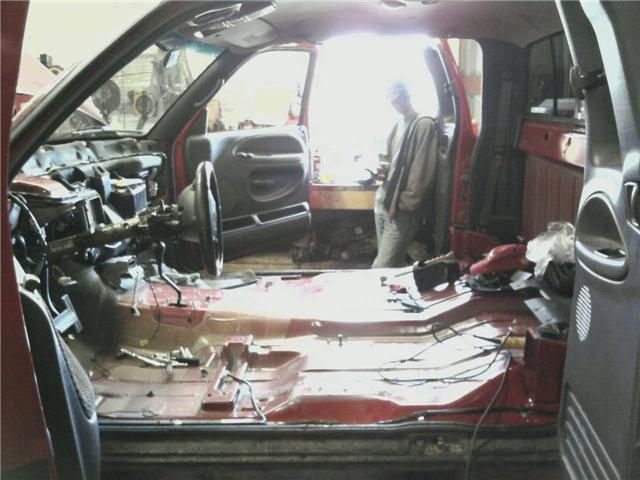

that's what the truck looked like last weekend when i did the heater core.

did you replace the carpet since it was gettin soaked daily? yall are lucky to have junk yards around you that actually carry newer models. and what did you do wrong when you took it out the first time? luckily mine does't have a notciable crack. i have one small crack down in the bottom right corner that runs onto the defrost opening, i just would want to minimize any further damage.

the hose clamps and hoses were old and didn't fit tight. So it leaked on the inside. I'm going to wait until august or a little bit later to replace it with vinyl work truck flooring. I hate carpet.
