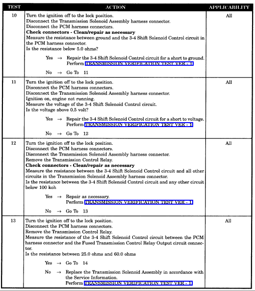

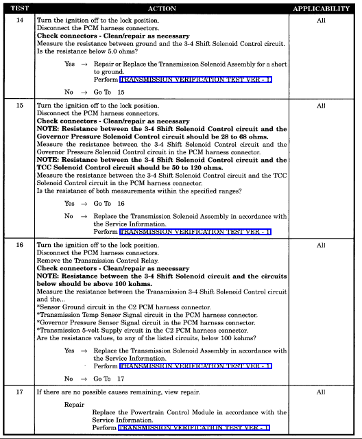

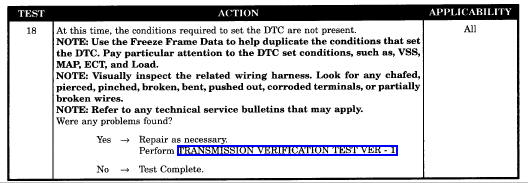

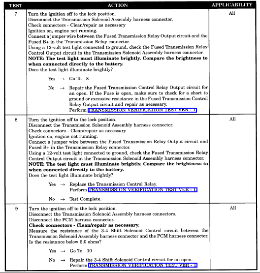

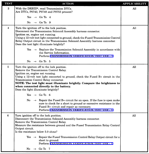

Old Jan 19, 2010 | 02:04 PM
helms's Avatar
helms
Joined: Jun 2007
Posts: 981
From: Langley, BC, Canada

honestly, my trans did the exact same thing 12 months after a dealer rebuild. It was time for a service anyway, so i pulled the pan and nothing was wrong. i put the pan back on, filled it up and it drove fine. that was almost a year ago now and i still have no problems. sometimes they just like to hiccup like that.
