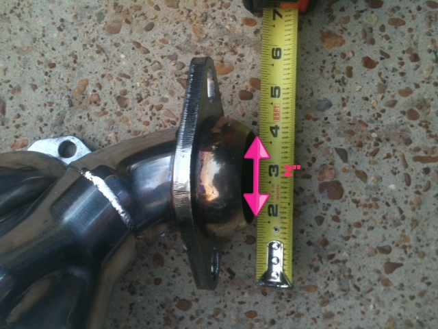

Got the Header off now again and going to try to replace the two hard to get to holes with very short 5/16 coarse/fine studs.
Kind of switching gears here, but on the flange, could I go up to at least a 2.25" flange couple adapter with the ball coupling end of the header collector? The opening is ONLY 2", but I would like for the exhaust to exit into 2.25" piping, to the 2.5" to 3.0" Y adapter. That will take some pipe expanding, but muffler shop can do that...

I would be tempted to trim that a bit, and open it up some more. Then use the 2.5 inch collectors.

I removed that whole piece from mine.
They were pressed in.

My muffler shop guy just flared some pipe out and built new pipes into a y and cut out the cat for 50 bucks. I couldn't get the stock flanges to seal up to the collectors on mine. The flanges were to small.

CLIPPER77: If I remove the ball flange as you did. . What type flange did you use to make the connection from Header collector to the new downpipes you fabricated.? I searched your post, but could not find any pics. or anything saying exactly how you made the connection. If I get rid of the ball couple joint/adapter, seems it would leave just a flat flange, and would need to use anothe flat flange with a gasket on the top of my downpipe that will go to the Y collector. Is that would you did..?
