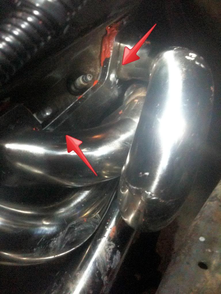

Default Can't seem to get the bolts in -Here is a pic.
I have fooled with every tool known to me ( I am an helicopter mechanic in the Military , and I can't seem to find a way to get these two ( inside bolts towards firewall ) started. I have tried shorter bolts, alllen bolts, stub wrench, ratcheting wrench, fingers, joint ext., swivel socket, etc. This is ridiculous for these bolts to be this hard to start. Again this is on a V8 360 gasoline engine.
Again how did anyone who has ever accomplished this with these stainless ebay headers do so...???

Loosen all the other bolts, pull the header away from the engine some, start the bolts, tighten those to snug FIRST. Tighten the rest. Torque to proper value starting from the bolts in the middle, and working your way out.
