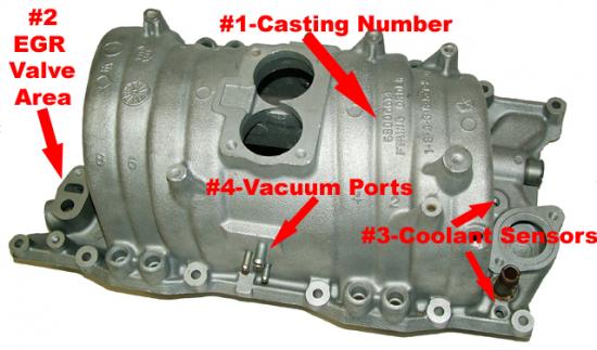

damn you made me go out in the rain and look.
no, the intake extends forward all the way over the front edge of the block. remember the little rubber gaskets on the front and rear edge of the intake set?
the coolant sensors, t-stat housing, air temp sensor, heater hose pipe, and wp bypass all mount to the intake. my 01 has a TINY little hole for the temp sensor. probably only 5/16" threads. i thought about the T off of it, but since its so small, i think it would be hard to T and it wouldn't be in the water flow.
since i'm lazy and prefer to do as little work as possible, i'd try to make to buy a connector for the heater hose and try that first.

trying a pic here.

LOL, your right. I just got back from the garage and they do go into the manifold. So basically there might be a plug in the one to the right of the thermostat.
Actually, the best thing to do would be to swap manifolds and replace the plenum plate while it's off.
