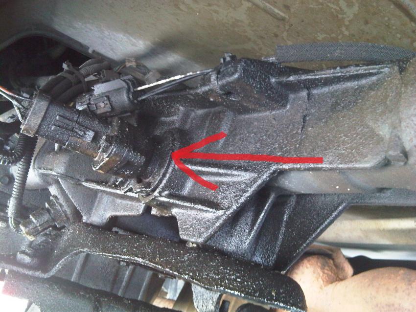

Here is a pic of the speedo sensor. Look for that if you find another tranny. The 98 tranny did not even have the spot for this sensor.

ok thanks man, helps out alot, ill most likely go and get the tranny this friday, i have a GPS as weel so i could live with that haha, wont really like it but i can get by haha. What sensor did you end up changing??? i would like to know because my sensors or something in the tranny i have whent out and it doesnt want to shift from 2nd to 3rd or back to 1st at a stop(i think the pressure gov sensors are out in this one i have) .
