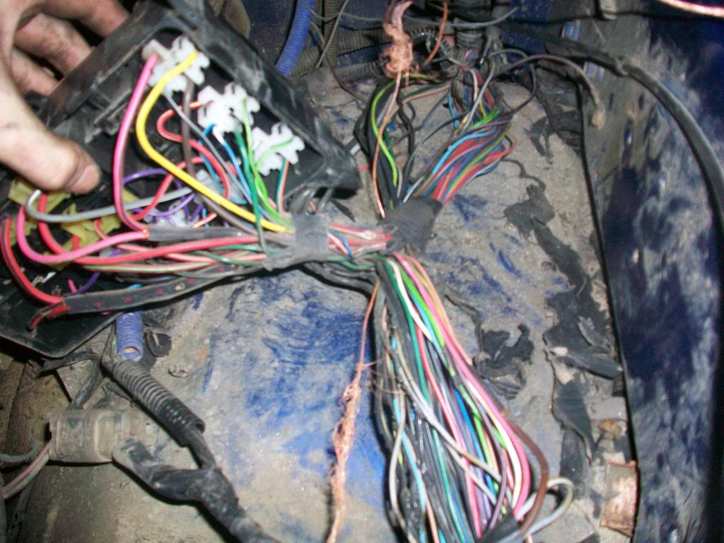

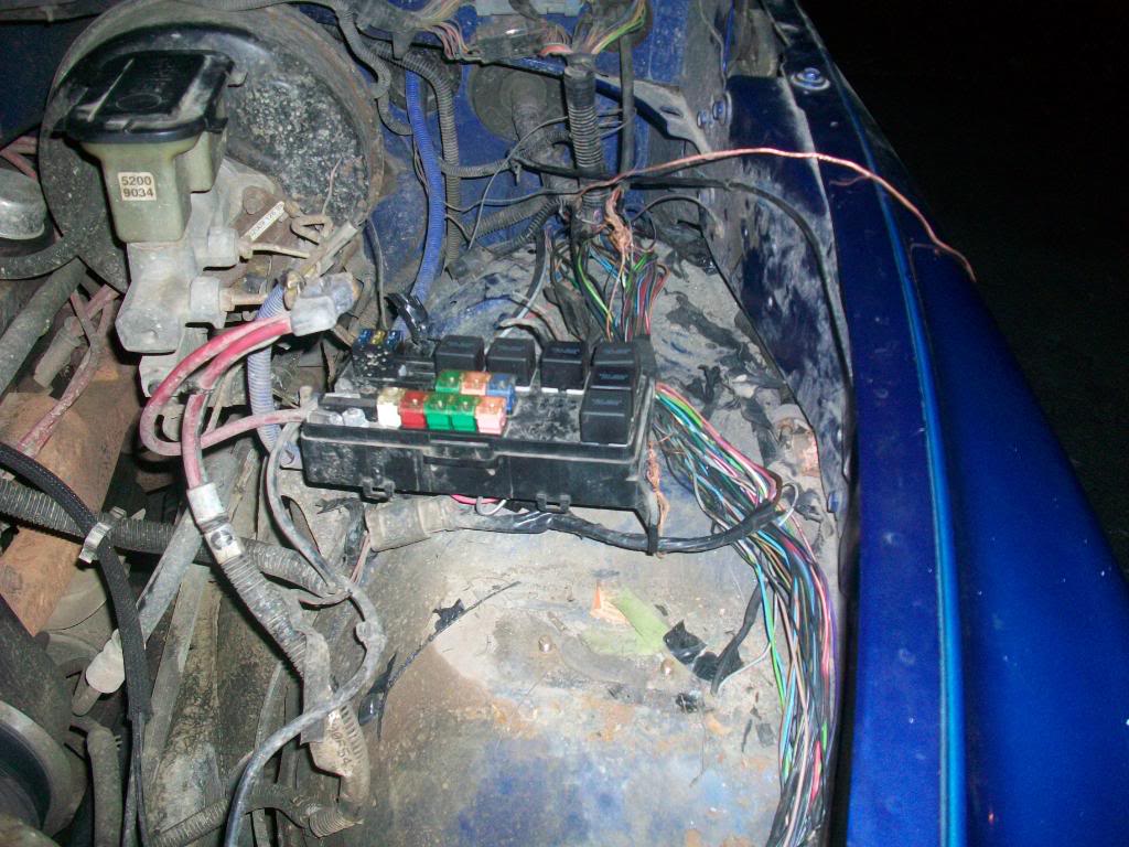

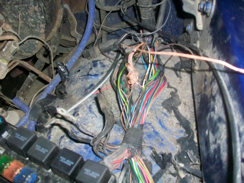

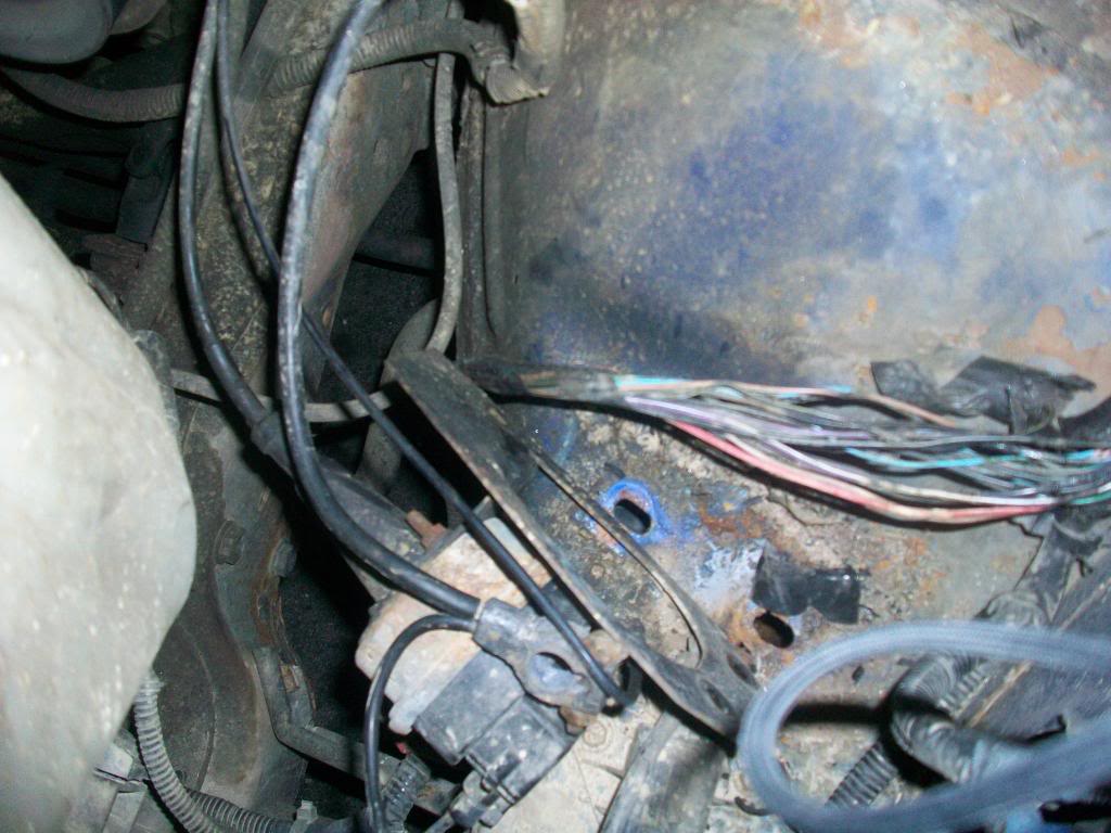

Ok i started today...Im starting with the wiring, and the burnt wires...i though it was only 2 wires, but i was wrong......i ripped out the battery box, took out the fuse box, and ripped all the tape off to find about 5 wires that are melted, and 2 of them go to my guage cluster, which i hope will fix my gas gauge, since everything else works...Ill be posting som pics of the wires tonight...looks like spaghetti under my hood right now, the whole harness and wires are separated and spread apart....going to replace the wires now...i hope to god this fixes my gas gauge, if not, at least i can relax a little and not worry about any fires....

im fairly good with wiring, it doesnt bother me....but they were all grounds, and i traced them all the way up the harness to where they all were fused into one wire....(up near the drivers firewall) where they fused together the wire was still good, and nothing wasburnt passed that....one of the ground went down to the front bumper, one went on the brake master cylinder, and i dont know where the other 3 went for they werent burnt to far down the harness, so when the wire got clean again, i spliced from there
ok heres the pics...this is what it was when i had it torn apart fixing the wires
