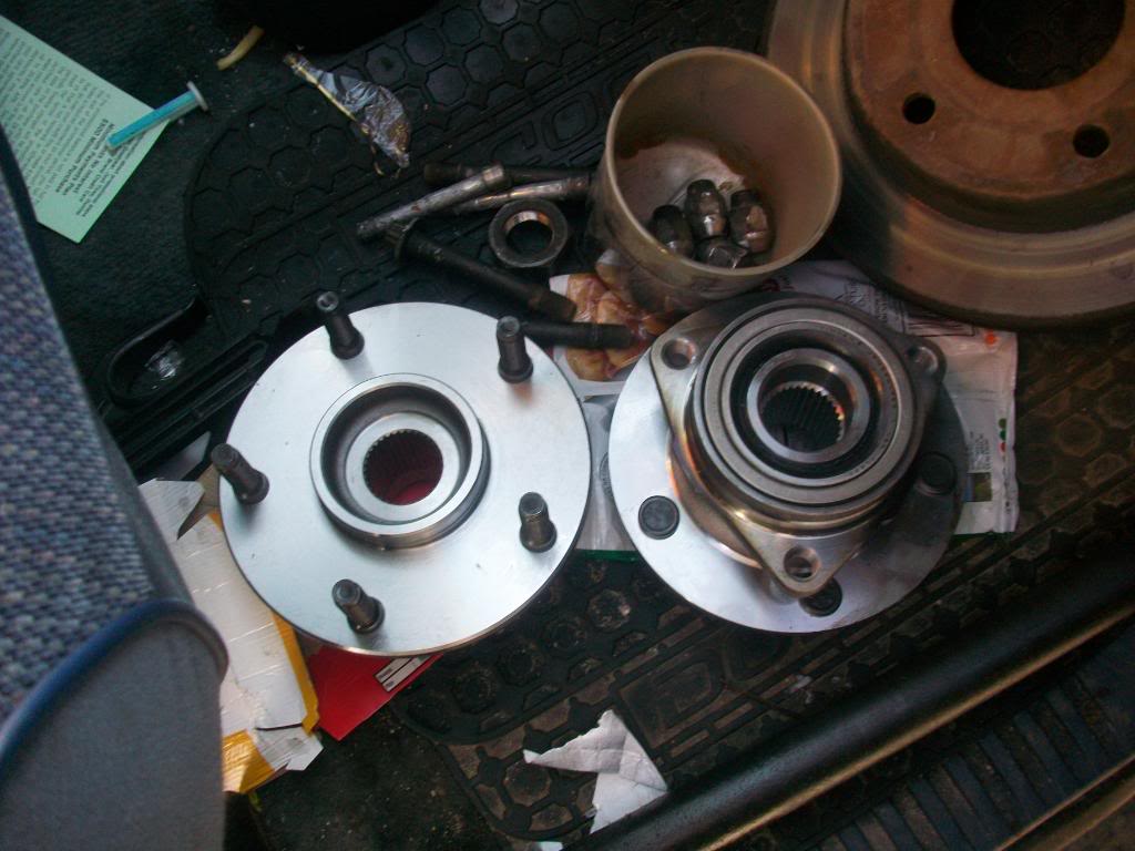

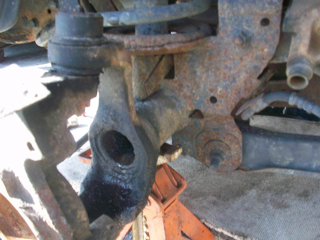

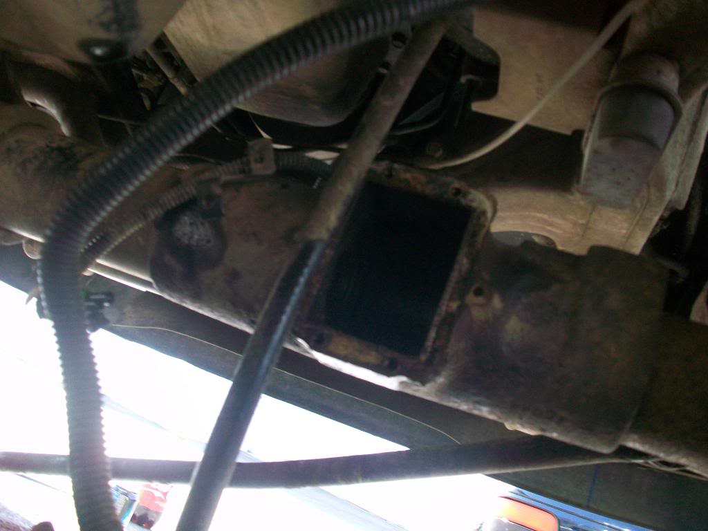

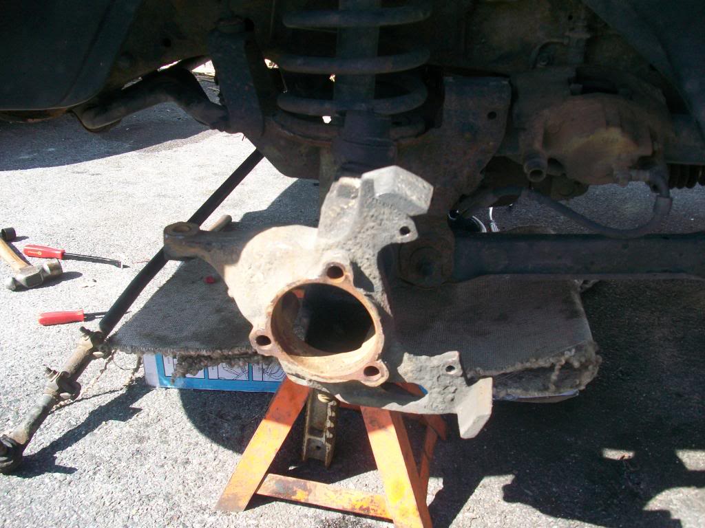

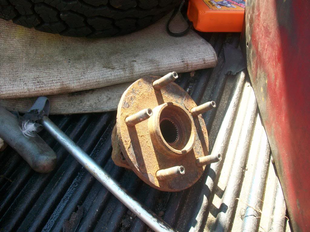

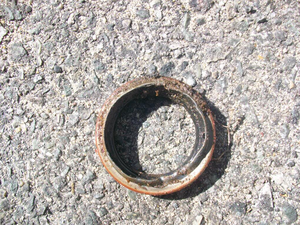

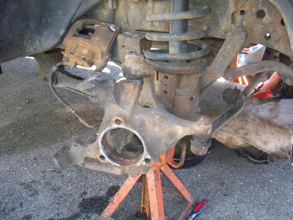

ok heres some pics of the job so far...the machine shop has my axle shafts and are doing my u-joints. They charged me 25 bucks to do both, which is a very good price IMO.
Im having a problem removing the carrier, i cant get it to budge, i had my buddy with me, and we used pry bars to no avail. I was thinking about getting a rope on it, andhook it to my fiancees maxima and pull it out, but i dont want the truck to fall off the jack stands...
Also im trying to get the pass. side axle seal in, and its giving me problems...It does go through the CAD side right? since thats the way the old seal punched out...Am i going to hav to get a long bar put it through the shaft/seal, with a washer n the other side and pull? (if you understood)
Well heres some pics. Ill have more later.

Did you unbolt the pinion shaft? That thing should just about fall out... not sure you have to, but I wonder.
Old Mar 9, 2010 | 02:03 PM
  #40
95RAM360's Avatar
95RAM360
Posts: 5,971
Likes: 45
From: MAINE
I have the CAD housing/shaft and axle shafts out, and the four bolts that have the two brackets out....is there something im missing? Im not familier with what your asking, its my first time digging into a front end like this...but im a mechanic by choice/trade, its my passion and i want to learn as much as i can for my hopes are to open my own garage one day.
this is what the write up says on Pavementsucks.com
Once the oil has drained out, place something under the diff that can catchthe carrier assebly if you drop it. I used a small sealed cardboard box inside a larger sealed cardboard box. Remove the 4 bearing cap bolts. They are torqued to 70lb-ft. I suggest marking the caps so that you can remember their orientation (left-right and up-down) as they are line honed with the axle tubes. I also kep the bolts in order as well.
Using 2 large pry bars, I pried on the inside of the ring gear and a ring gear bolt on the back side. You do not need a case spreader with the Dana 44 even though the case applies the bearing pre-load. You will pop the carrier out of the main bearing races and drop onto the bottom of the case. You may need to use the pry bars again to get the carrier past the outer edge of the housing. IT IS VERY HEAVY. Also keep the bearing races on their correct sides. "
