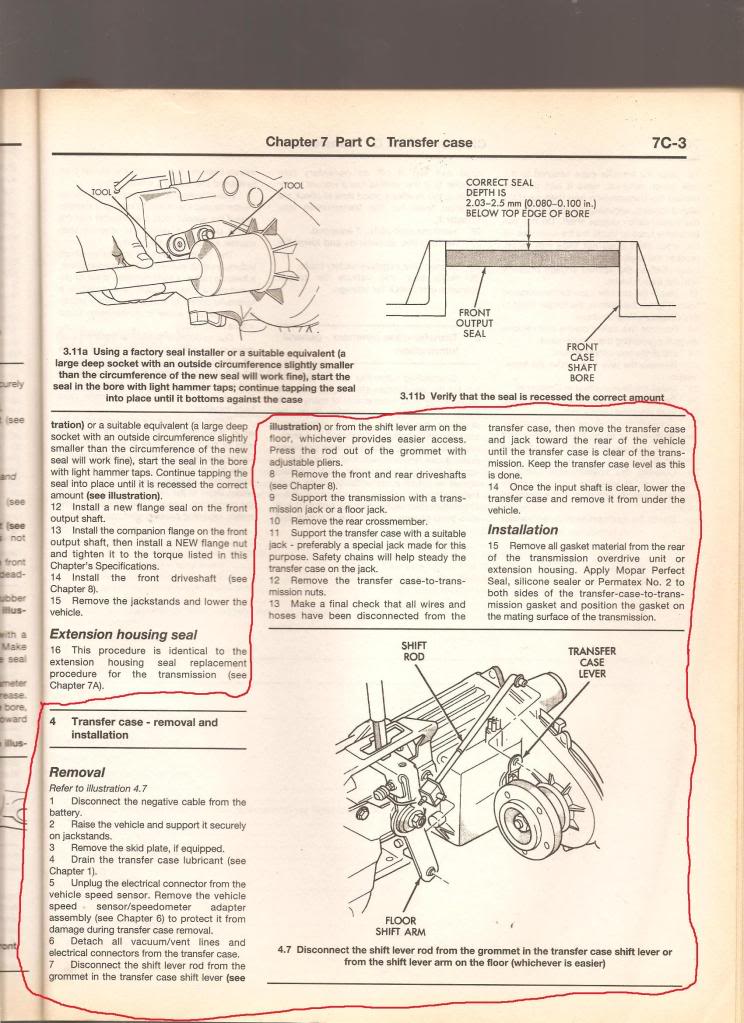

Buy a Haynes manual

The top bolts on the transfer case can be a challenge. You need to lower the tranny down as much as you can then you may still have to use a stubby wrench on the bolt to get enough clearance to get them to turn.

They are actually a stud with a nut.(not bolts) Sometimes the whole stud/nut will come out as one. But yes, as Sungod said, the top ones can be a pain with out the right tools.
