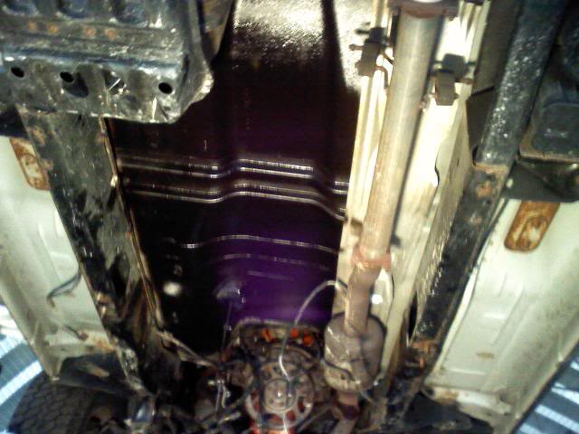

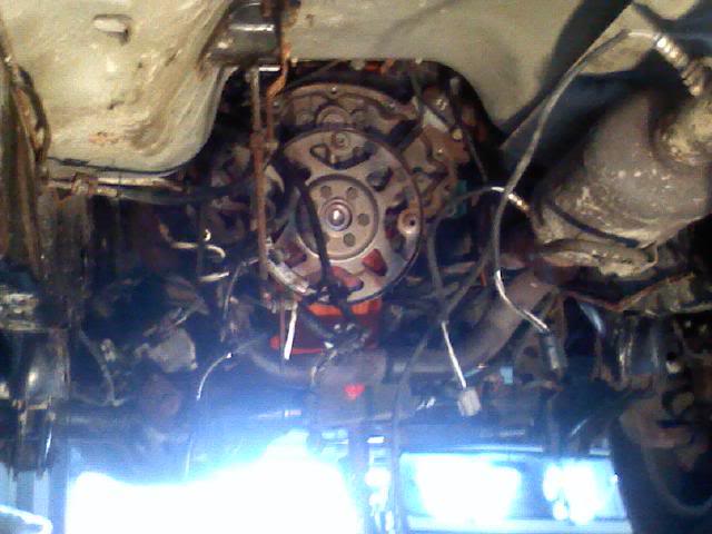

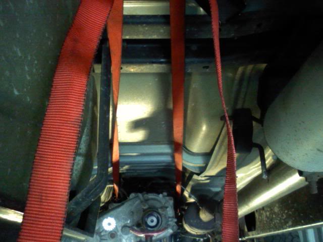

Finally goth the b**** out today! I had a little trouble with the dowel pins. I took, some pb blaster, cargo straps, and a lot of wrestling to get it loose. I didn't quite have enough time to start bolting the new one back up, so I decided to go ahead and undercoat where It would be difficult to when the tranny's back in. One question though: what is the best way to clean out the cooling lines?

glad you got her out.
remove the check valve.
i'm no expert, but i would just blow them out with air. put a rag over the end, as it'll make a mess. blow out the cooler too.
while the transmission is out, inspect your freeze plugs on the rear of the block and heads. if there's any doubt about their condition - replace them. maybe replace them anyway.

nice pics....how bad did you have to wrestle it

I had to fight pretty good. In a final, p****d off rage, I yanked the transfer case back and forth and the driver side pin popped loose. The next one was easy. I'm headed out this morning to get er done!
Also, I checked my freeze plugs. They look new!
