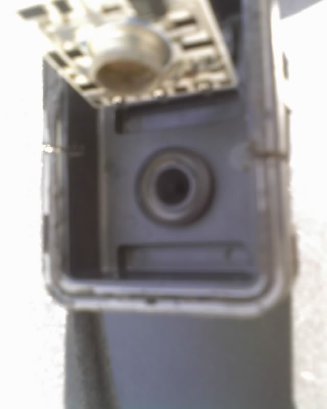

The nipple that connects to the manifold:

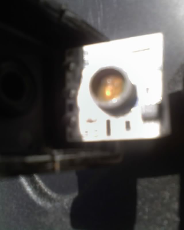

MAP cut open, showing the curcuit board:

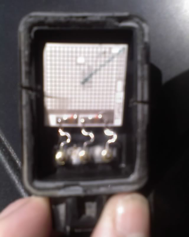

Curuit board lifted to show the pressure sensor on the back of the board. Still soft and pliable:
Hole in the housing that the pressure senor sits on. The other side has the nipple that connects to the manifold:
