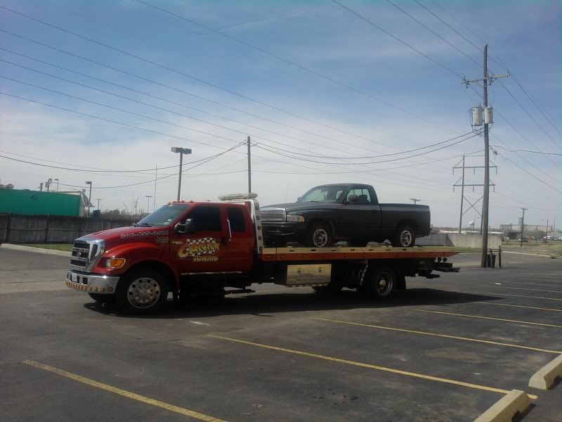

I also want to Thank Tom and his Wife for all there help!!! With out them we would have been lost and stranded. Thanks again!!!! Here is a few pics of the dodge with my cell phone so sorry about the quality. Thanks
