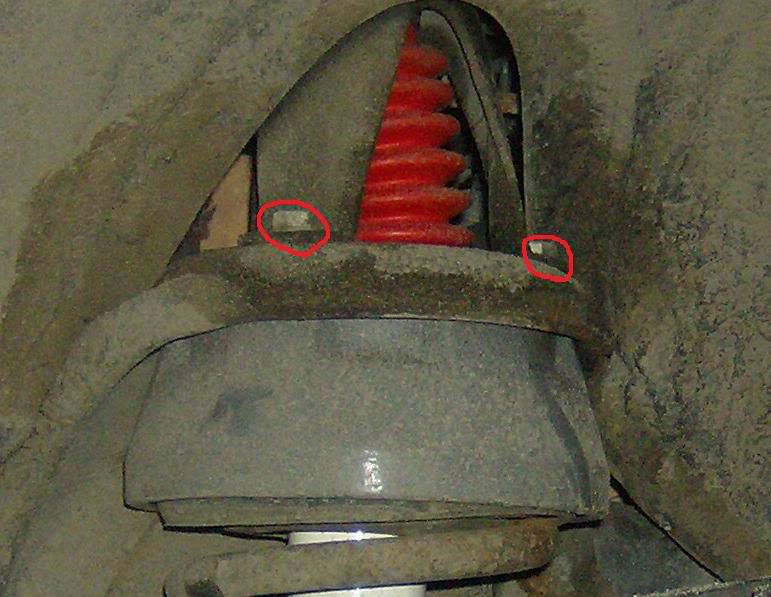

Unlike this pic i dont have studs....YAK I thought about that , but i dont think it will tweak far enough because the coil spacer is in the way,it takes up alot of room on the inside as well for the shock to clear, im out for tonight , but have all day tommorow to figure it out, Thanks

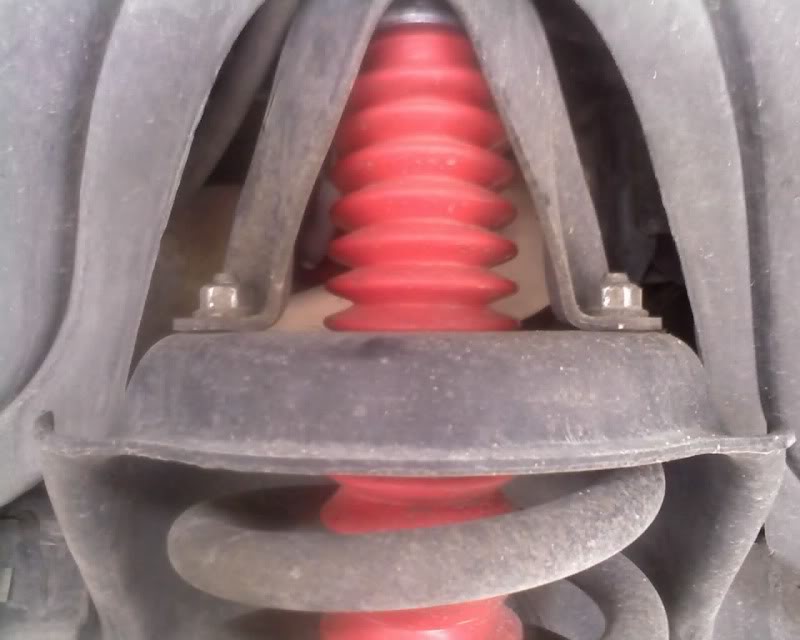

This is how the originals look. If you cut or drill them out, I think you'll still need to remove the springs to put new studs or bolts in. I say compress the springs and try to get a socket underneath. Good luck. It looks like a pain.

it looks like your studs have been cut out and replaced with bolts, and the damn nuts are buried in the spacer.
do you have a parts store close by? if so, the easiest and safest thing to do is compress the spring so you can get to the nuts. you can rent spring compressors. if you keep the spacer, and you have a welder, you could tack the bolts heads underneath to recreate the original studs.
if you jack up the body and extend the spring, can you expose the nut ? with shock disconnected, make sure you don't go up so high you allow the spring to twist or contort or jump out in some manner.
