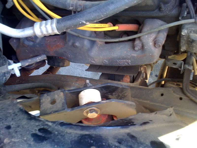

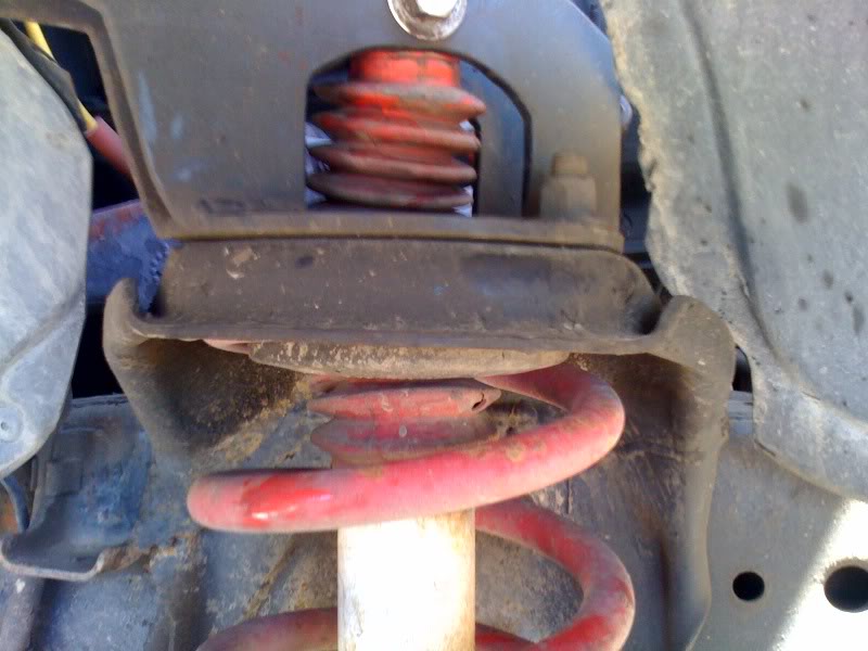

Best I can tell you is I can run 35's and only rub at full lock. I am trying to up load pictures of my suspension.

Wow I have never seen a shock tower like that on a 4x4. Must be part of the Dick Cepek lift. Hopefully someone will chime in the with correct answer.
Old May 4, 2010 | 05:40 PM
Posts: 87,395
Likes: 4,213
Looks like Extreme Suspensions bought out Dick Cepek close to 10 years ago...... at least, the suspension end of it... You might be able to call them for some "real" information..... Best I can figger out though, is if you do NOT have the stock control arms on your front suspension (or, they may be just boxed.....) you prolly have a 5.5 to 6 inch lift there.
