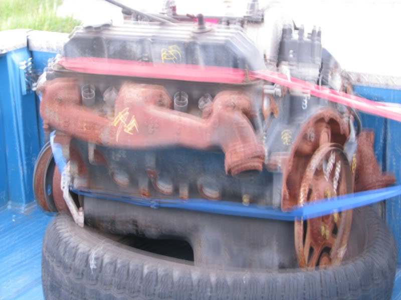

I am downloading the manual and have pulled engines before just not out of a dodge
Mine is a 99 4x4 5.9
any tips to help smooth out the r&r would be great
The replacement engine is all there from the pan to the intake mani
minus all accessorys

you can swap any engine as long as they are the same displacement. Just make sure you use the newer intake. The 1996 has the divider.
Other than that, it is nothing different.

just make sure every sensor is connected. Then you will be fine. The only thing you might need to do isget a different crank position sensor, and cam position sensor for YOUR YEAR of truck. They have different connector tips for different years.
I know...I had to replace my wiring harness when i had a fire under my hood. long story, no fault of the truck.
Or you can just splice so the connectors fit. But make sure that you have all connectors connected, and there will not be a problem. If you have any problems, just snap a quick pic and post here or PM me. I can help with the underhood wiring.
