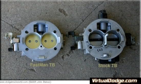

yup i have 52mm fastman,pacesetterlongtubes,and 1.7 HS trying to sell my k&n CAI, because i put a 10x3 on i love it motor sounds so much better . i have a highflow cat too which is a big diffrence in sound and performance.
here is the fastman you could make your own to start off if ya want just cut off the **** on the top for better flow Name:  wm_normal_255837.jpg
