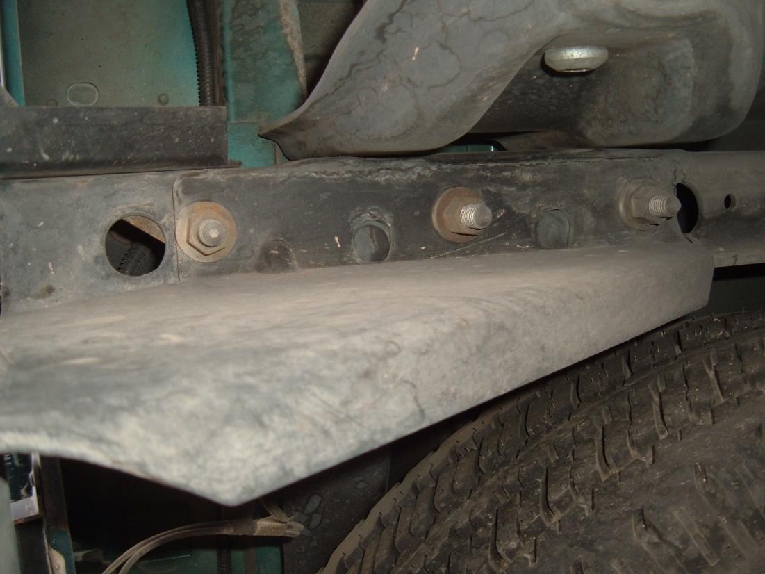

could some one with a class3 and some one with a class4 take a tape and see how long the bracket that goes along the frame is because I was reading on a web site the bracket on a class 3 hitch goes farther back on the frame than a class 2 and a class 4 goes farther back than a class 3.

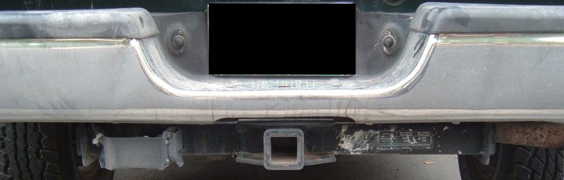

Originally Posted by BigRedRam95
could some one with a class3 and some one with a class4 take a tape and see how long the bracket that goes along the frame is because I was reading on a web site ....
Hopefully three pictures are worth three thousand words:
That's a factory tow package hitch.

that is what I have from the factory. you can find them in the junk yards real easy. completely bolt right up. the yard around here charges 40 bucks for one. it is a substantial piece of hitch. most even say mopar on them
