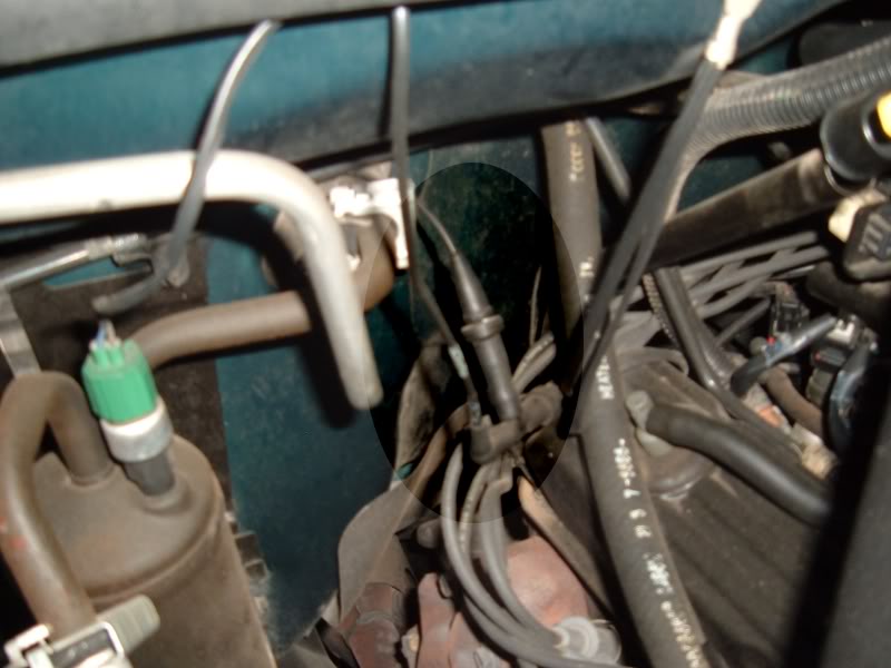

when u say downstream u mean toward the HVAC right, I just wanna make sure im going the right direction, I did find a second check valve just off the intake manifold on the pass. side. Its actually in one of lines feeding the second check valve up by the heater hoses. I havent had a chance to get under the hood far enough today to check that one. I also saw a funny looking thing on a vacuum line just behind the manifold by the distributer. Kinda looked like a broken check valve or something. I want to look under the hood of another 5.2 to see if it has the same thing. Ill try to get a pic tomorrow of it.

Yep -- by "downstream" I actually do mean closer to the vent control than to the intake manifold. I suppose that technically it's upstream...
Is this the widget that looks like it might be broken?

It shouldn't look broken.

that one is the one i checked, the one that looks broken is on the other side of the intake manifold beside the distributer, I had a tooth pulled yesterday and the meds are keeping me from looking farther into this, I dont want to mess anything up, I tend to be a little tipsy and absent minded. Im putting it on hold for a few more days. Ill be back under the hood this weekend.
