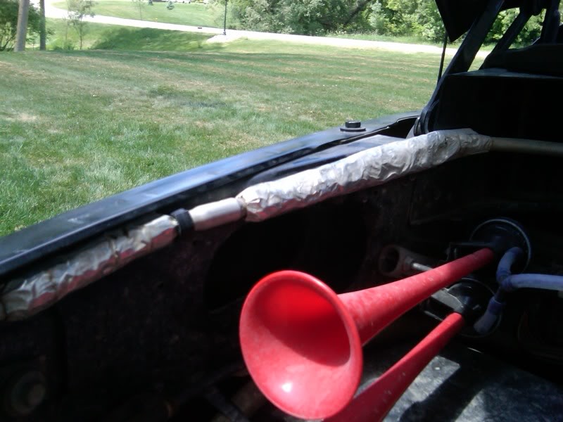

alright so i went to check out the exact location of what i think is causing the freon leak, here are some pictures of what i would like to call the "trouble area" haha, so by looking at this i think im going to get a section of flex hose to replace the normal hose with because if im correct (which im usually not) the aluminum foil looking crap is not stock, right? and the leak with stuff comming out is a clog from some of that fix leak stuff that was put in the system, so im thinking if i knock out the entire section from the high side input port, all the way back to the drier, and replace it with some universal a/c system tubing from say napa or something it could possibly work since i think this to be the problem spot...

That foil stuff is insulation and is stock, or at least I think it is as mine has it to.

Erm, I don't think splicing in hose,and just using screw clamps is a very good idea........ The system operates at over 100 PSI........

yeah i wasnt going to use screw clamps, i talked to my automotive guru grandfather today and he was telling me that it runs at like over 1000 psi or something like that, so we decided that instead we would pick up some aluminum tubing (which i think the original system is) and we are going to flare the ends of the replacement and original tubing on both ends and use some brass fitings (essentially like a brake line repair)

Yes the foil is stock. The high pressure line is all aluminum, the chances of it cracking are slim to non. Another reason why you have to have the oem line is there is a orifice in there that regulates the flow of refrigerant, with out that orifice the system will not cool. It is possible for the orifice to get plugged and not allow flow. Really it's not that expensive to replace the orifice tube and accumulator/ dryer. I spent less than a 100 to replace mine, that was through Rock Auto.
